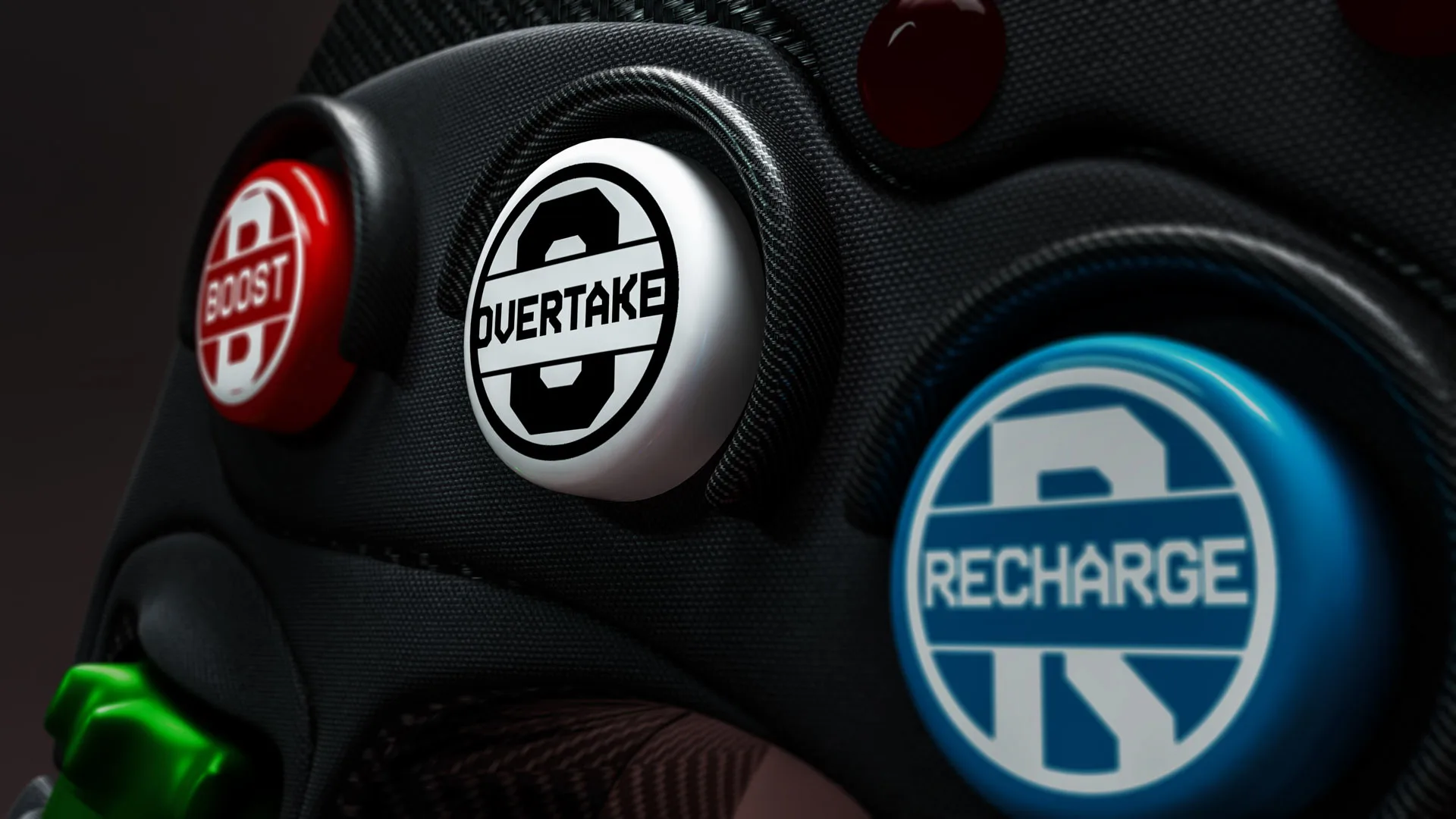

Rule-makers say drivers will have more power in their hands to make decisions over energy deployment, regeneration and conservation.
The new rules mean cars will have a series of modes which will be indicated on television graphics to aid the audience's understanding of the action.
Overtake mode: Replaces the current DRS overtaking aid. A burst of extra electrical energy available when drivers are within a second of the car in front to deploy power to assist with an overtake.
Boost mode: Driver-operated energy deployment from the energy recovery system that can be used in attack or defence. Gives the driver maximum power from the engine and battery at the push of a button.
Both these modes will have to be used with calculation as total energy is limited.
Active aero: The front and rear wings adjust angles - open on the straights for low drag and speed, and closed in the corners for maximum downforce.
Recharge: Drivers can recharge their battery with energy recovered from braking, or on throttle lift at the end of the straights or in corners where only partial power is applied.
Lando... go ride Pedro's bike!
F1 thankfully changed all the terminology for the aero and deployment modes. Now we get Boost for regular deployment and Overtake for the DRS-like aids. Also Active Aero will be open and closed, no silly X mode.
There’s some important details about Overtake that I haven’t seen before. There will only be one detection point that counts for the entire lap. Overtake allows for a greater recharge amount and a greater boost. So Overtake isn’t an extra thing for the drivers, it’s just more boost to aid in passing when stuck in dirty air.
The fact that drivers can use an extra 0.5MJ anywhere on track should make Overtake passes a lot more unpredictable than DRS passes. And they may even happen more frequently. Drivers previously could use their deployment to defend a DRS pass, cuz they knew when the attempt was coming. Now the passer can wait out the defense and use their extra Boost later in the lap.
F1 is also adding auto-close functionality for the Active Aero, like for T1 at Suzuka. It’ll work off track distance, not an external marker. That way drivers don’t have to brake, lift, or press the button like w DRS.
One detection zone for the whole lap? I know where some of the drivers are going to use their boost...

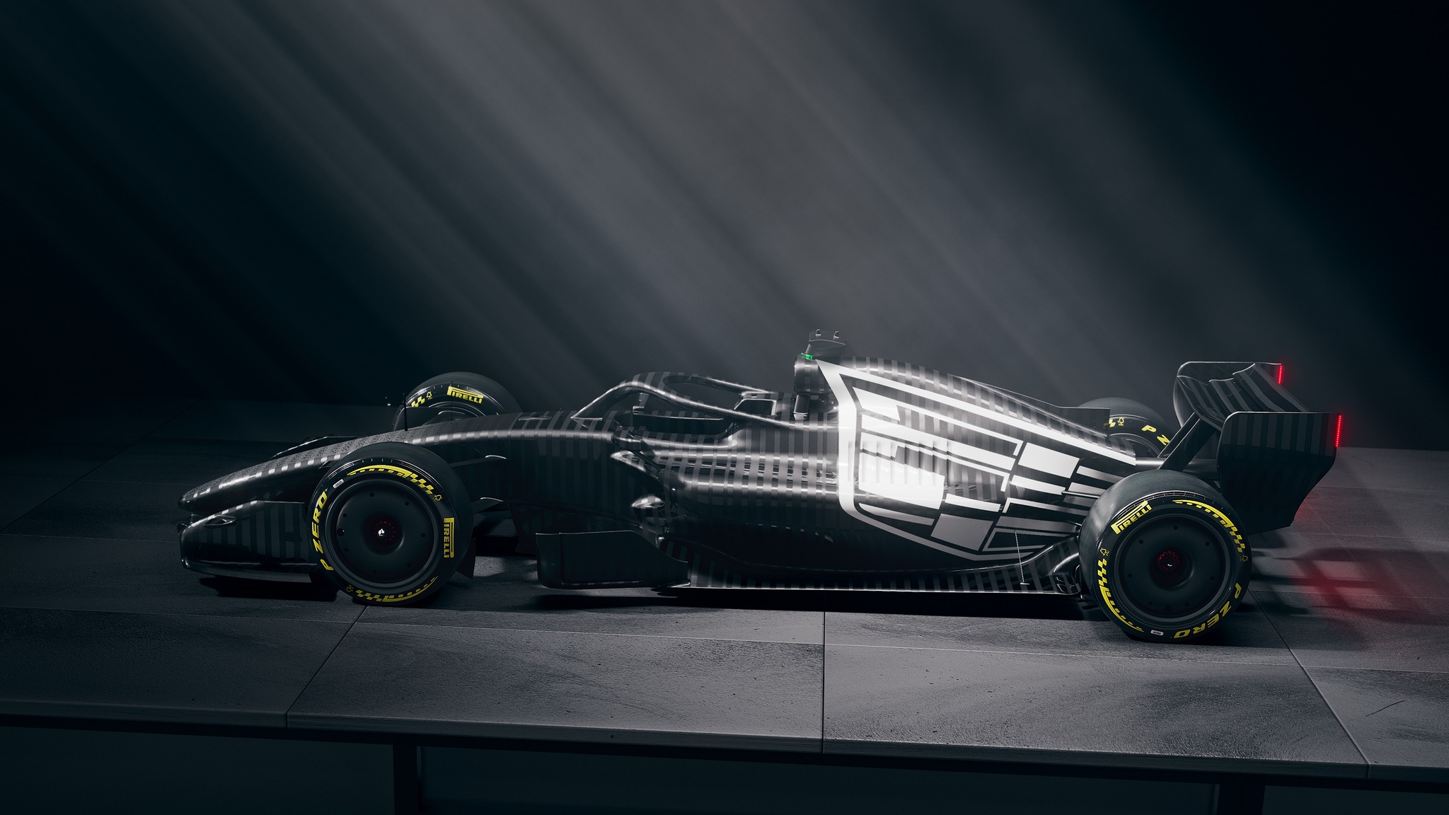

With Cadillac and now HAAS revealing their cars, it's confirmed that Ferrari is going to a pushrod front AND rear suspension setup. HAAS purchases Ferrari's gearbox and carrier as well as it's rear suspension. Cadillac uses Ferrari gearbox internals, but manufactures their own casing. Cadillac is going with a pullrod front suspension for now.
