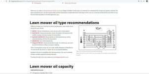

I read a few things that might play a basis, 1) Hotter air cooled temps 2) Splash type lubrication instead of an oil pump so oil gets where it needs faster 3) Anti foaming properties due to splash type system 4) Orientation of the camshaft/valve system/piston angle
Any how, I found this chart on briggs & stratton's website
https://www.briggsandstratton.com/na/en_us/support/faqs/browse/mower-oil-type-and-capacity.html
attachment.php
Different oil types can work best at certain temperatures. Learn which one to choose for your climate.
SAE 30- Warmer temperatures, most common oil for small engines.
SAE 10W-30- Varying temperature range, this grade of oil improves cold-weather starting, but may increase oil consumption.
Synthetic SAE 5W-30- Best protection at all temperatures as well as improved starting with less oil consumption.
SAE 5W-30- Very cold temperatures.
Vanguard 15W-50- Varying temperature range. For continuous-use, such as commercial lawn cutting or pressure washing.
When choosing lawn mower oil, use a high-quality detergent oil classified as "For Service SF, SG, SH, SJ" or higher. Do not use special additives.
Synthetic oils are an acceptable oil at all temperatures. The use of synthetic oil does not alter required oil change intervals.
