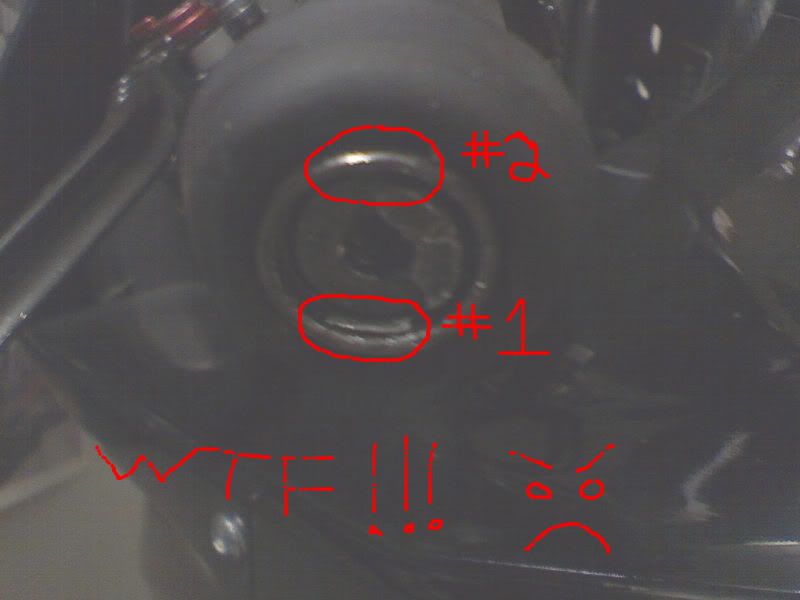

I have an 04 CBR600RR and I have been ATTEMPTING to install a bar-end mirror (CRG) but have failed horribly:(
The 2 clip deals are now broke off :thumbdown #1 you can see... It should have a "lip"... the #2 (above which you cannot see) is like #1 :( I tried to do it the correct way by "pinching" both clip lip things then slide out, but they just bent and snap'd off after a couple attempts:thumbdown
Ya'll got any ideas on how to remove this thing? :twofinger

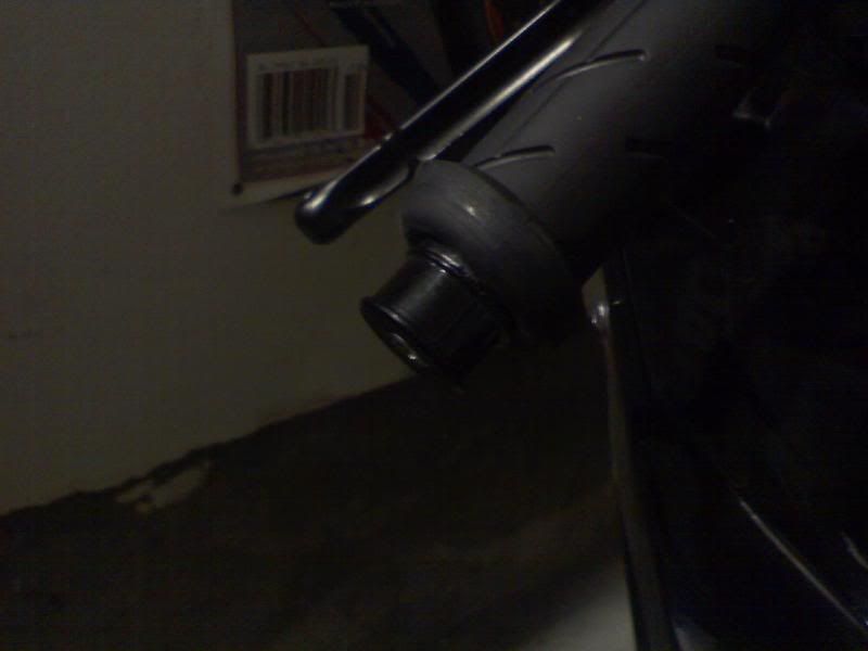

I already tried useing the stock bar-end and just kinda folded over the grip (as you see in the picture) and the bar end AND the mirror just spun in circles... It was "on" but at freeway speeds I'm sure the weight would flip it (the mirror) upside down. Am I tracking you?

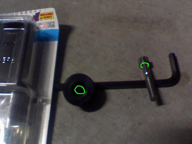

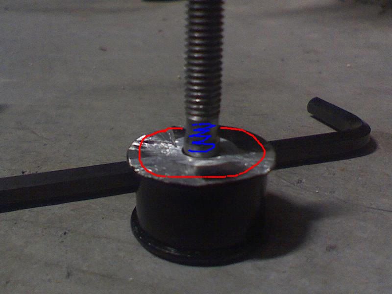

PIC#1 Blue will just touch the weight Red will touch the handle bar its self
PIC#2Green is where the bolt goes into the slot and would secure it to the bar-end deal

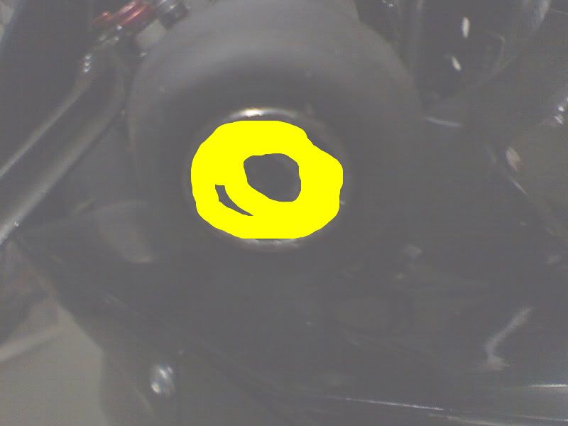

PIC#3Yellow Gob the shit outta it...
if the weight is spinning, thus allowing the adaptor to spin, put epoxy where you made the yellow turd in the last pic
if just the adaptor is spining relative to the grip/bar/weight i'd cut up a bicycle innertube and make a rubber washer then honk that screw down really tight so nothing is permanent. you could bond the screw to the adaptor like you have in #2 also. put REMOVABLE loctite on the threads when you install it tho, hell do that for any situation

holy crap .... check it out ... If you remove the grip or throttle assembly ...you will see two holes, one on each side of the bar... Find something that can fit inside and press them together, While you do this do a swoop motion ..This will cause the weight to slide out .... you really dont need the tabs you broke ....This is the way ive removed them all the time... If you have a hard time ..bring it to Tech day and i can give ya a hand
