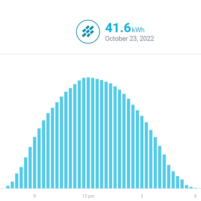

I just had a solar system installed and am not sure that my current time-of-use rate plan is what I should have moving forward.
Does anyone else with solar have a recommendation on what the best rate plan is? I tried to google it and must not be using the right search terms because I didn't find anything.

I just got one earlier this year. It seems like the solar company talked to PG&E because they now know that I have a PV system. I don't have a battery system to run off at night, so I just stuck to my 5-8 plan (that is, avoid using electricity during that time) and roll with it. If you have a way to store the power, that might impact your choice.
It looks like you are a net producer, so your charges will be minimal regardless. Otherwise, it depends on how disciplined you are for using electricity off peak. I use the EV2 because it has the lowest off peak price but the highest peak price. During peak hours I am either producing electricity or try to use very little. If you need to use during peak hours, a plan with a cheaper peak usage would make more sense.
I basically changed my plan a few times during the first year I had solar and found the one I preferred that way.
Log into your PG&E account online and go to your summary dashboard. One of the tiles will state your current rate plan (tarif) and if you click through it, PG&E will estimate which plan would work the best for you. I went with the 4 to 9pm tarif when installing solar, but am considering the 5 to 8pm tarif. PG&E estimates the 5 to 8pm will cost me about $45 more a year than the 4 to 9pm, but I can better manipulate my consumption around the 5 to 8pm period than the 4 to 9pm.
Once you make your decision regarding which one to use, you can change it on the website. It may take a month for the change to go into effect.

My true up has been typically $0.00 so not sure it matters at all for me.

I underproduce somewhat, so I reverted back to E-1 (old school tiered rate.) Otherwise I was producing during non-peak and consuming during peak.
