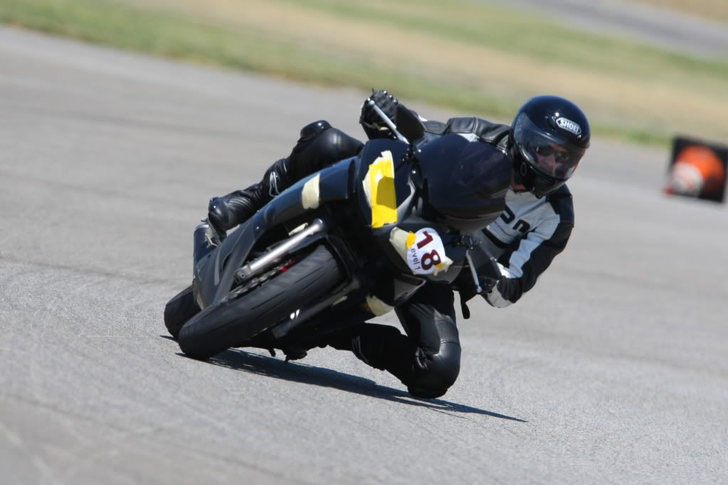

As far as their lean angle though - at the track, I'd lean it over a good bit, and it would feel like it was about to slide out, as though all the sudden the bike went waaay over onto the tire - I couldn't tell if this was just the PowerPure tire profile and I was on the side of the tire, or if I was indeed nearing a lowside.. Whenever that would happen, I'd immediately straighten the bike up a bit, feeling like I had to save it - thing is though, when I felt I went way over on the tire (more than the below pic - it's only happened a couple times, neither recorded), it didn't feel like it was slipping per se, just that all the sudden the bike "fell" into a much more dramatic lean..
When I checked the track pics I had some pretty good leans, but they didn't look as extreme at all as the motoGP pics and such (granted, they're pros and using race tires, but still, I'm trying to ascertain the limits of traction)..
Here's a pic of my bike at the track - those are the powerpure tire - does the bike look like it has much more lean angle in terms of the tires here? That's about as far as I've leaned it I think.. I'm not sure how we as riders are supposed to find the limits of lean angle without crashing at some point? I sure don't want to crash, but it would be fun to lean the bike over further (and thus go faster through the turns at the track) if I knew I had more traction available..

I wouldn't compare your leans to MotoGP racers. Those are just ridiculous angles that they reach with experimental tire technology and a team of engineers behind them. Your peg feeler isn't even on the ground in that picture (and I realize camber plays a roll). Those feelers are there for a reason. Your body positioning looks pretty good, which means you're far more likely to scrape foot pegs before your tires give out. You still have more room for error.
If you really want confidence, have your suspension set for your weight. It sucks in the 650r since nothing is adjustable, so you have to have your internals adjusted.
But if your main goal is faster lap times: lines. Once you've touched your knee down yay. The real trick to speed after that is learning the right lines. After that you have proper braking points and trail braking and how hard to get on the gas and where. But how far you can lean has little to do with how fast you're going to go. I've had people pass me on the outside when I'm dragging knee and it sure wasn't because they were leaned over further.
From your picture, lumber, you are in fact at your bikes maximum lean angle. If you want to go faster, you have to figure out how to balance the bike through a corner in a way that doesn't require leaning the bike as much. You've got to move your body off the bike and towards the center of the corner while making turns. This keeps the bike more upright for the same cornering speed. Your chicken stripes will come back. Once you figure this out, start increasing your speed and your lean angles will come back.

No. That's with Woodcraft high rearsets, plus the relocator plate that's another 1.5 inches up and back, I think. So ~3.5 inches of lift on them and I'd still drag them at certain places on the track. Now, that happened because my BP sucks, but that's not the point...the point is the tires can absolutely take the lean angle.
