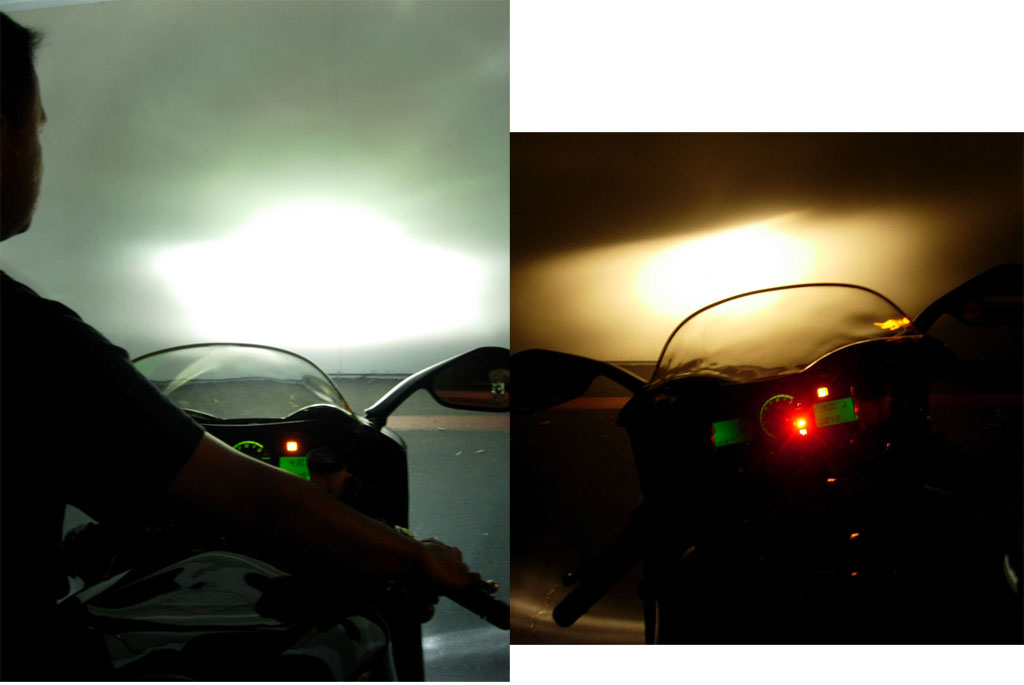

Your headlight is a reflecor-type, and looking at your picture (pattern on garage door), I think you have the D2S bulb which is suited for projector applications.
If this is the case, you should consider picking up a D2R bulb. You will barely notice a difference in light output, but it will eliminate that glare 'hump' on top of the usual cutoff line, and therefore protect oncoming drivers.

Thanks Alan,
I looked at my bulb and indeed it has the metallic strip. The strip runs through the entire lenght of the bulb.

This picture tells the whole story:
It has nothing to do with the angle of the bike for this particular picture...they are close enough for comparison.
The problem is that big hump of light that is now present with the HID kit which was not there with the halogen.
What Stan pointed out (about the ground being much better illuminated) is absolutely awesome! What isn't awesome is that rediculous concentration of light above where the cutoff was engineered to be.
There are kits out there that will illuminate the road the same way without casting so much high intensity glare at oncoming traffic.
Stan: I wouldn't even try askign you to take off that kit and try another. What I'd like is for the next adventurer to do some more research and try a more bike-friendly kit instead of seing just your praise and deciding to go with the same kit you have.
Enjoy your newfound light!
~Alan

Fair enough - Stan's cutoff is certainly not as good as I've seen on other bikes (mine included), and could do with some attention.
I was generalizing about modern sportsbikes because that seems to be the primary market for accessories like this.
