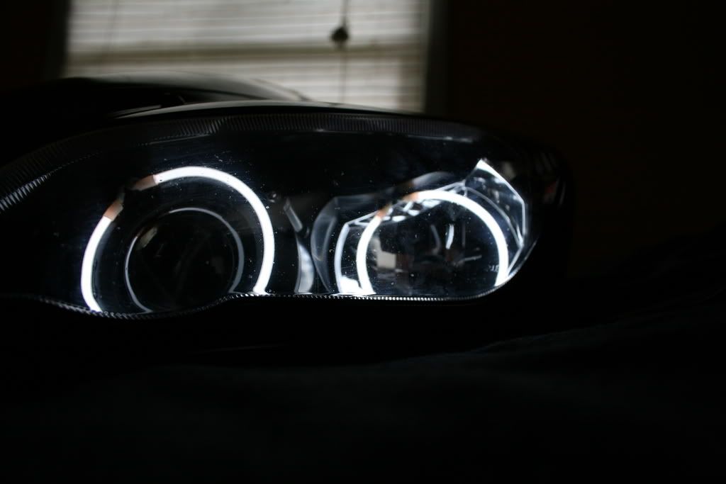

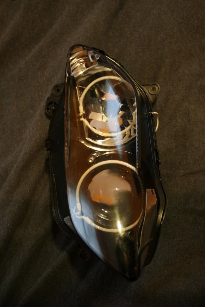

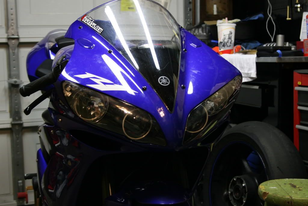

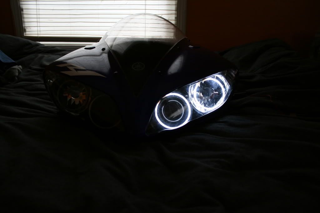

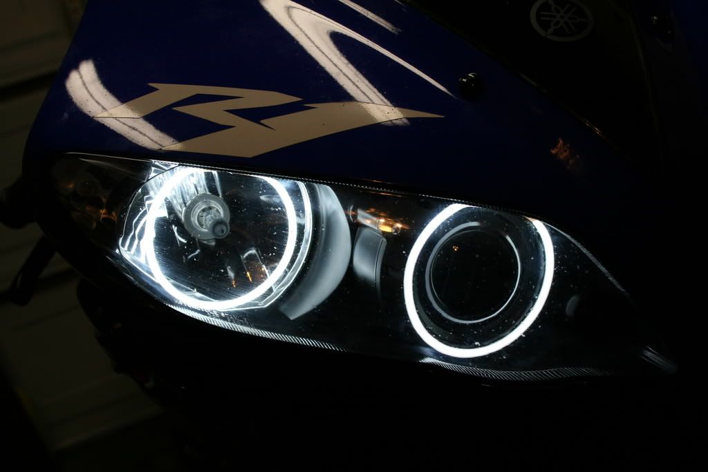

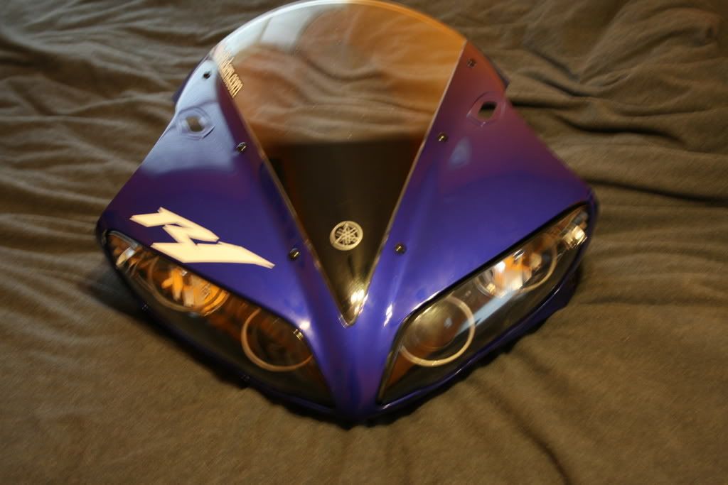

ok update part 3, I spent my lunch break working on getting the lights back together.
Step 12: remove the tape from the Halo lights and lightly tug on the halos to make sure there not going anywhere.
then place the lens back onto the headlight, and use a hair dryer to head up the Silicone sealant. Im not sure if the Halos could take the heat in the oven....so i didnt chance it.
Step 13: reinstall the lights into the upper fairing-
Step 13.5: pose real quick lookin so good working on that bike :cool

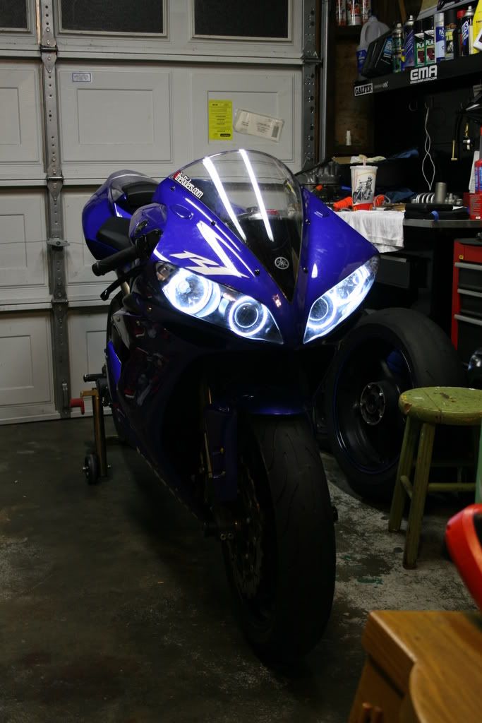

Step 14: test the lights with a 9v battery...note that these lights are designed to be run on a 12V system so they will be brighter! :teeth

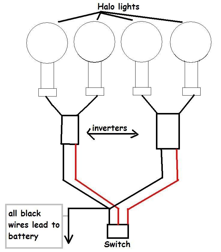

HELP!! Wiring problem
OK, i have a 3 wire switch that has a little white light on it, I have all 4 of the reds spliced into each other, and the 3 black wires are spliced together into a connector that runs straight to the battery.
i turn on the bike and it no works : (
I would run it like this. I never usually connect the neg to the battery. I connect it to another line.
What i would do is connect the red and black to the + and - of the headlight, and have a switch between... just splice the wires connecting to the headlight.
Those switches are strange, IIRC they need 2 seperate power sources are something weird like that. Its been awhile but they don't work like you'd think
WOn't work, he's trying to hook up a switch that has a built in light in it
USE A FUSE, and on second though, use a switched power source, and relay if you have too.
Ok... No problem...
The tabs on the switch SHOULD be marked...
Tab 1 Should be Power Source.
Tab 2 Should be LOAD (ie: Lights)
Tab 3 Should be ground

:wow :wow :wow it looks even better than I expected!!
I usually don't like this kind of stuff but I have to admit it looks pretty kick ass :thumbup
