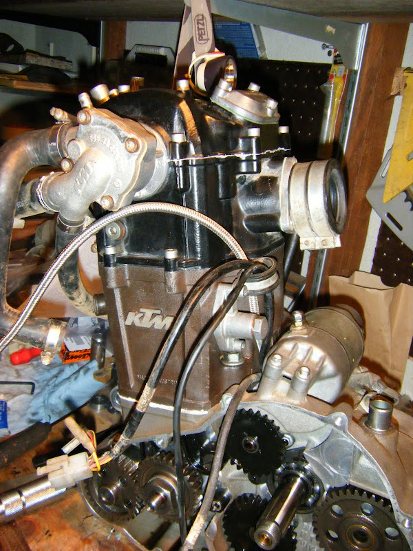

On with the pictures- I spent a good part of sunday assembling, cleaning, etc.
Here goes:
Got the cam in and timed right:

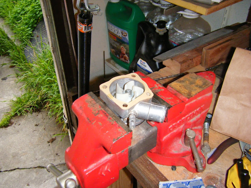

Waterpump rebuilt, new seals and bearings, but it'll need a new wp shaft next time for sure. . . what is it about ktm and waterpumps?
Waterpump and rocker cover on:

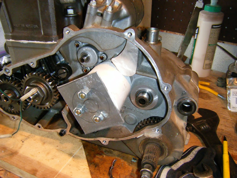

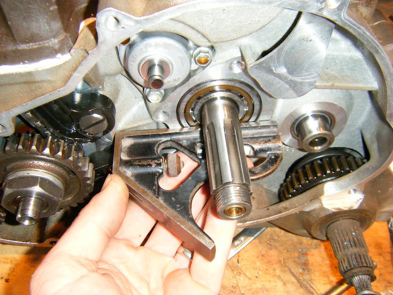

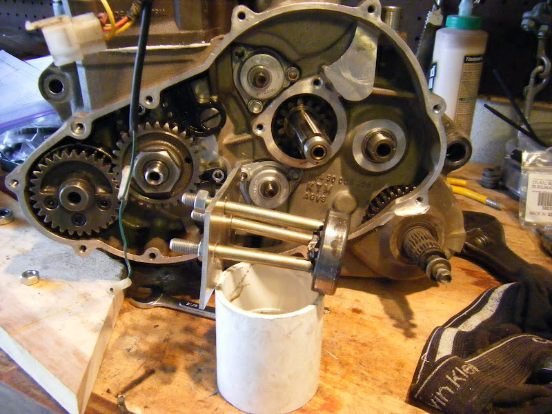

Next up: extracting the main shaft bearing:
Making the puller from 3 5/16" grade 8 bolts:
And it's out:
Okay, it wasn't quite that easy in real life. It didn't budge on the first attempt, so I heated up the case with a propane torch, squirted some ATF around the bearing, and tried again. Slowly but surely, it came out.
Install the new bearing, flush with case:

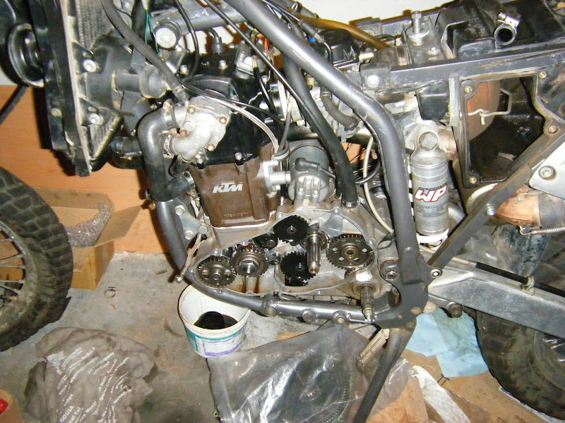

I found that one of the plastic oil pump gears seemed worn, so I'm going to leave off the clutch until I can replace it. In the meantime, the engine can go back in the frame:
And all the electrical/carb/cooling stuff can be hooked up:
