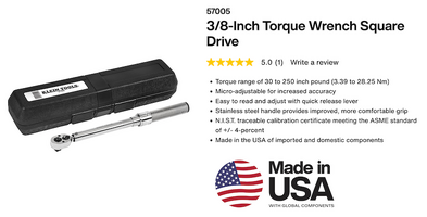

Any recommendations for a medium quality non Chinese/Taiwan torque wrench. I need it for the those smaller torque ranges like 8-30 ft lbs.
I found Precision and Wright tools, but they did not go low enough.
So far, this seems to be what I may order. I have emailed the manufacturer of this Ingersoll Rand (3/8" 7-35 ft lbs) to see where it is made. An AI search says Japan, but at $120, it seems low.
I do have a 120 to 960 inch lbs from Taiwan, but for me it opens up errors in estimating the calculations between increments. But, thanks for bringing Klein up as a US made tool, I will remember them when my large torque needs replacing.
