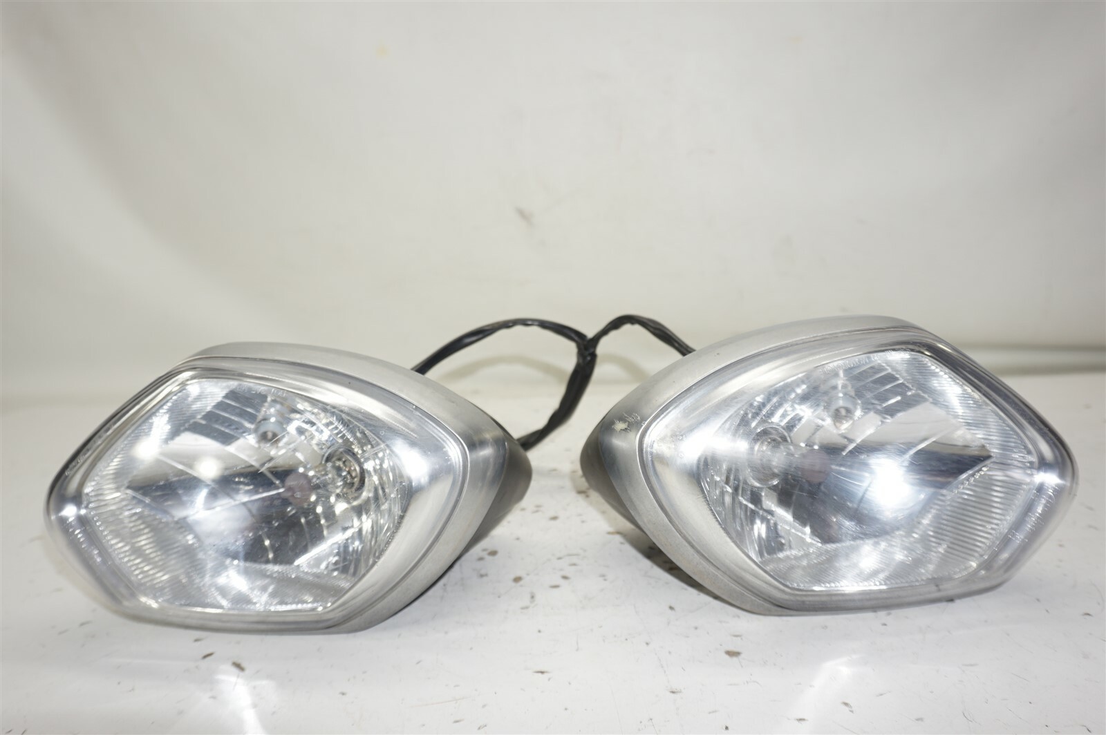

this looks right?
https://www.ebay.com/itm/13-18-TRIU...riumph&hash=item4465598351:g:rugAAOSwUaFfcikB

Pair of bulbs for $345...
https://www.ebay.com/itm/07-08-09-1...896052?hash=item217205afb4:g:M1IAAOSwtP9e~JOQ
