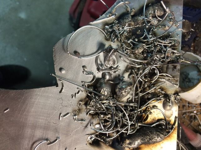

100% argon and brand new tank. I can't even get a spot weld out of it even on thin metal. Other welders have gotten nice beads with this machine even on the 3/16".
So I went and got a brand new stainless bristled brush and alcohol and scrubbed the crap out of it including the area for the ground clamp and was rewarded with this.
3/16 plate and it either acts like the metal isn't grounded at all with the wire bouncing off or it just zips through it like a plasma cutter.
This guy is trying.
I have nothing. I've never seen good results with a spool gun. Are you sure argon is the proper gas (I really don't know.). I know I had an argon tank with my TIG, and the guy from Santa Rosa that came and bought it ran a bead on a couple pieces of aluminum that were in my garage, sounded like bacon sizzling
I'm not sure about dc spoolgun on Al - as far as I remember Al needs AC to help clean the puddle.
Double check your shield gas.. I got an Ar refill once at a place in San Jose but the dude effed up and filled it with CO2 mix - the resulting welds were horrible, the carbon getting cooked out. Also, with Al, clean clean clean. I keep a couple of stainless wire brushes aside to use on Al only. Then a wipe down with acetone and let it dry off, Al oxide will cause the arc to wander immediately.

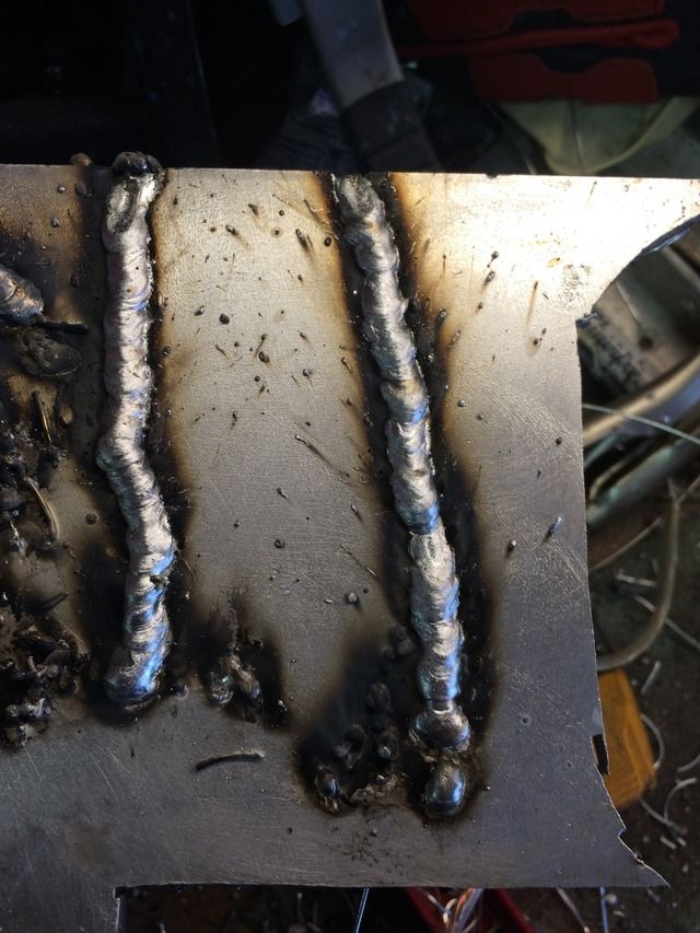

A little luck...
Put the tip on + and then turned the heat and feed WAY down. With the heat at half I kicked this out on 3/16" plate.
A little luck...
now that's an improvement. sure you weren't having a seizure or something before?
Not sure. Quite possible. In fact it would be a nice way to explain it away. ;)
I assume the black soot is an argon adjustment? Or is that normal?
I wouldn't know. I never welded aluminum before.
getting closer.
some black soot with alum mig is normal,
temp looks a little cold still. too much crown
do a bead and cut the material perpendicular to the bead to check crown vs root.
