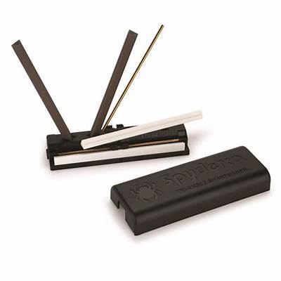

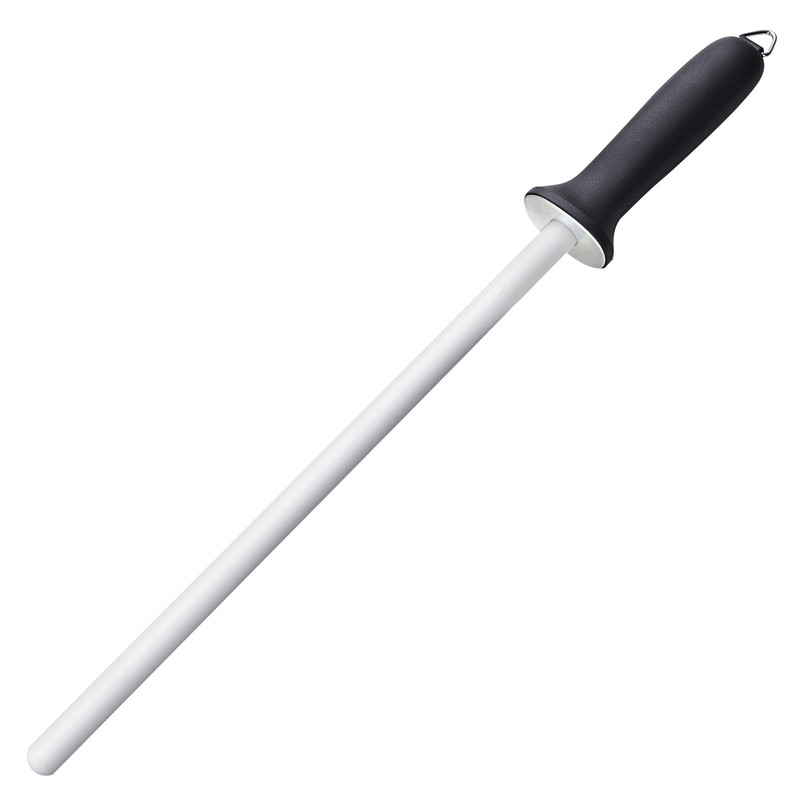

I carry both these in my bag triangle sharpener is handy you can get diamond rods for it ,I never let my knifes get that messed up I need to take a diamond rod to it
The ceramic sharpening rod put a nice edge on the knife,but if you drop it..may buy a new one or be good with a hot glue gun
