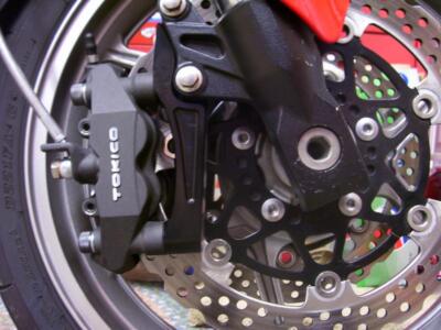

These look like what you need if you want to go fixed 4 piston:
Made to use the Tokico 108mm radials that almost every GSXR used from 2004-2010ish, also used on plenty of Kawi and Honda sport bikes.
You should be able to get used calipers for less than $100 on eBay or CL. I gave away mine when I swapped to R6 Sumitomos on my track GSXR. Just avoid the ones that use 4 pads per caliper.

Am I misunderstanding something? That bracket allows a radial caliper to be used on an axial mount fork tube.
Assuming the bracket can take the forces, it's the best option.
Another option: I put Tokico 6 pot caliper from an early 2000's ZRX on my T3 triumph (1995). Bolt holes matched up with no modifications. If that is what you originally had in mind, I can give you the bolt hole distance for reference. And if that works, there are lots of Triumph 4 pot calipers available. Those are lighter than the 6 pots and should be sufficient for something like a versys. My Tokico 6 pots are very heavy.
Yes, please. I'm not terribly interested in trying to convert to radial mounts, short of buying new forks, and that would blow my budget.

Using my Harbor Freight digital caliper, I get 80.1 mm hole center to center. Assuming a bit of error, I'd round to 80 mm.
