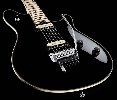

I think I talked to manny about this already but icr... My pops had this peavey "wolfgang" guitar when i saw him when i wet down south awhile back. It was some special limited Eddie Van Halen addition. The thing about it was not only was it fucking sexy :drool but it had this cool drop D thing. Is that something I can put onto mine???

no, you can't put a d-tuna on your strat. The bridge is different, those are made for the double locking tremolo guitars.

And you don't need one of those instant drop-D tuners. I had one guitar that had one and it was worthless. You'd still have to fine tune the sound so it wasn't as seamless as those things are supposed to be. Besides, it only takes two seconds to drop your #6 to D. :laughing. If you want the ability to go back and forth between low and high during a song, just get a seven string. :D

With a router and time you can do anything. :teeth But the D-Tuna does require that you already have a double-locking bridge.
I've installed a bunch of Floyd Rose type bridges on Strat-style guitars, and this includes both guitars with existing Fender-style vibratos, and "hardtail" fixed bridges. The latter is much more labor-intensive since I removed a ton of wood and the opening for the bridge block goes straight through the body. In both cases the pivot posts must be precisely set from the nut for proper intonation range. If not, you risk running out of saddle travel either forward or back. You have an option to either install locking tuners, a behind-the-nut string lock, or replacing the standard nut with a locking-style nut (again, this takes much work and allows very little margin for error).
Jaysin, since you already have a tremolo system on your axe, I would suggest a set of locking tuners. As long as the string slots in the nut are correctly shaped (odds are they are not, but I do have a set of specialized fret files) you won't get slack between the nut and tuners that leads to tuning problems. Guitar Fetish (yes that's the name of the site) sells hardware at excellent prices...a set of 6-in-line chrome lockers for your Strat is only $25.95. :thumbup
