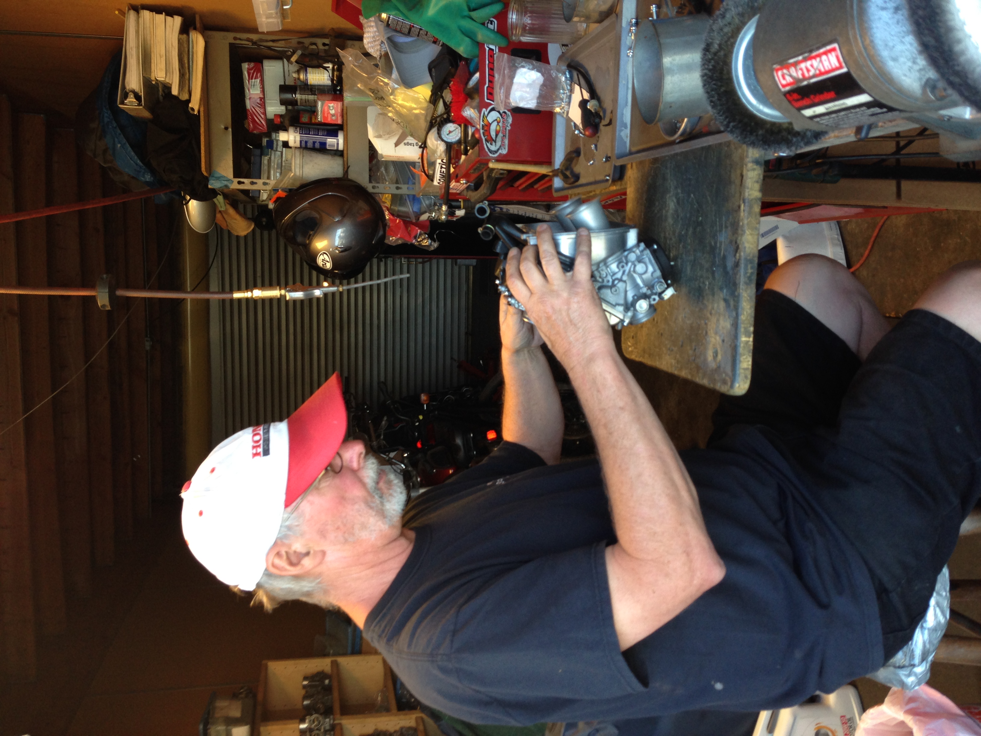

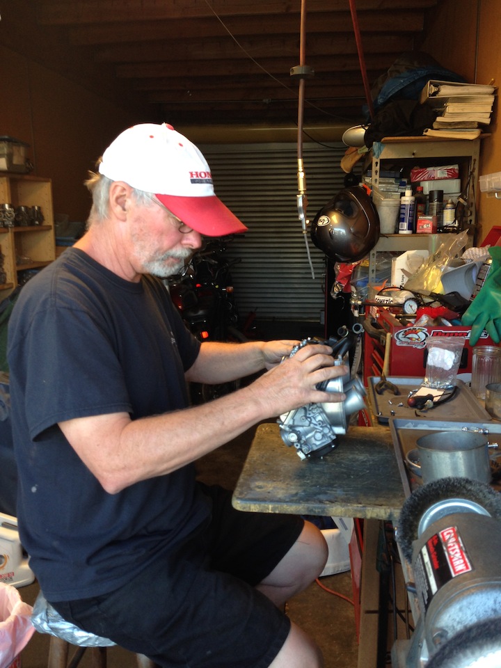

There's something really nice about working with guys who are craftsmen. Sometimes you really do need to enlist the help of someone who's been there and done that.
On Wednesday, these very shiny specimens get added to one RVF400 assembly and, hopefully, magic will happen.
