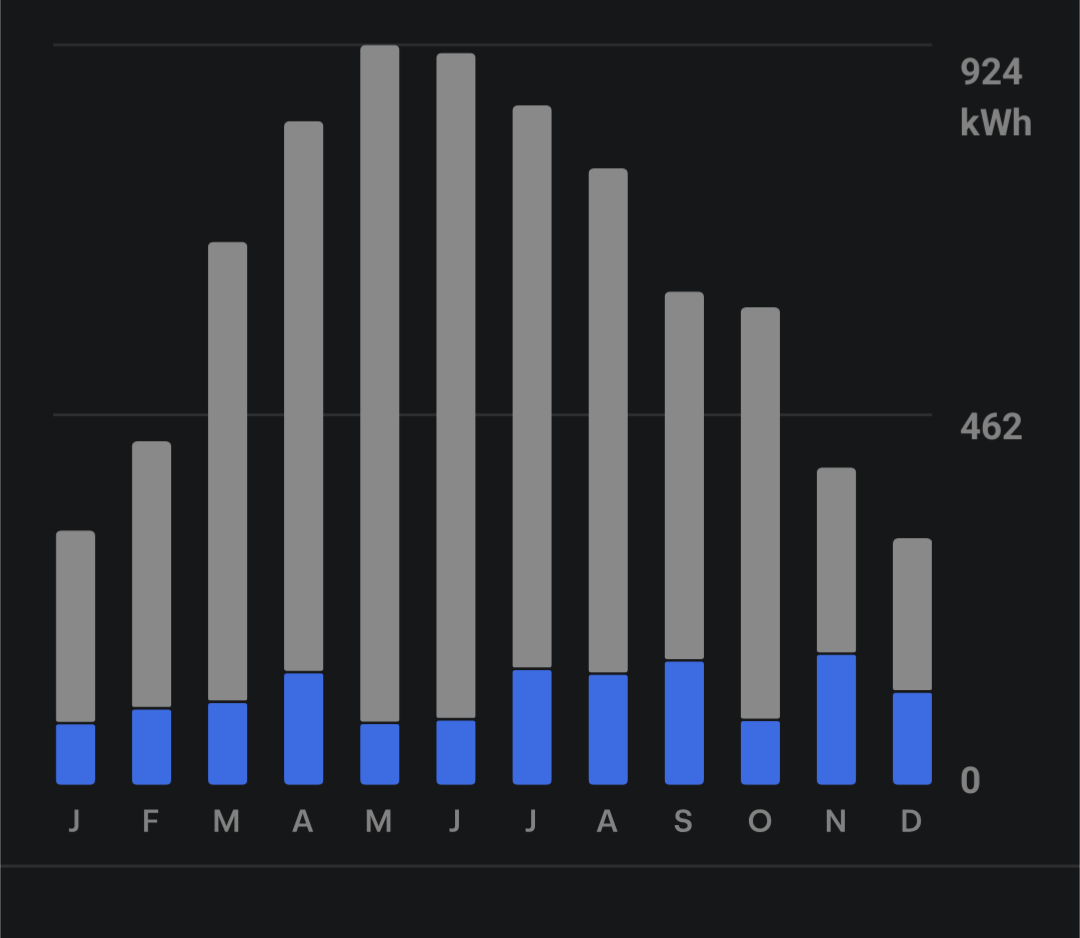

This month has been rough for production in my area. The aggressive Tule fog has all but zeroed out any solar production. Normally, production goes down. You can see what my panels did in 2023 by month:
By the time we get to December... I'm generating for fewer hours, less effectively. As another data point to the fog, in 2024, I was pulling 25-30 kWh in early December. Now I'm lucky if I'm getting 15, with many days coming in under 8.
