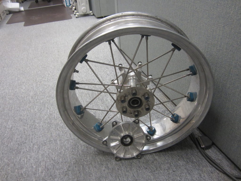

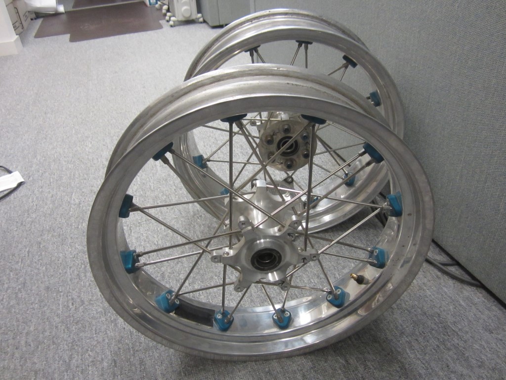

I also have a set of almost one-off tubeless spoked wheels: https://www.motorcyclistonline.com/do-we-need-low-cost-tubeless-spoked-wheel and my recollection is it's a 5" rear. I was considering putting them on the trackbike 426, but being able to fix a flat is very convenient. If I run those I'd run a 160 rear, and chain clearance would be pretty tight (but that's true on both the streetbike and the trackbike).

Where did you find the James Parker wheels?
Someone on a forum (SMJ) wanted to know if he could make WR wheels fit his YZ, he posted a picture. The answer was no. I offered to pay him a finders fee (they were posted for 600), he sent me the link (but I couldn't get him to take any money) and got them for $600 shipped.
