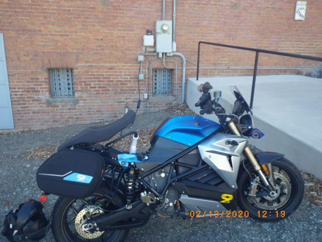

But not really always true. I charge my 2017 Zero SR with power tank (NOT charge tank) at 6.3 KWs while on the road. From J-1772, or a Tesla Destination charge station or even a 240 VAC outlet. See my Zero SR charging here, with my chargers. There I am charging from 120 VAC and 240 VAC at the same time. 120 VAC going to the OBC.
I bring two Elcon 2.5 KW chargers, one in each side bag. I wire them to the motor controller battery connections and also use the OBC for a total of 6.3 KW. I charge as fast as 8.4 KWs at home, by adding in two Delta-Q chargers using a Tesla Tap for the entire 8.4 KW from my 12 KW Tesla Wall Connector.

Holy Jaezus that is hella plugs and wires, big ass boxes and fans and stuff. It looks like most of what you're carrying is charging equipment! :wtf
This looks better.
At least with the SR/F you can still get the power tank and have the 6kw charger in the premium version
