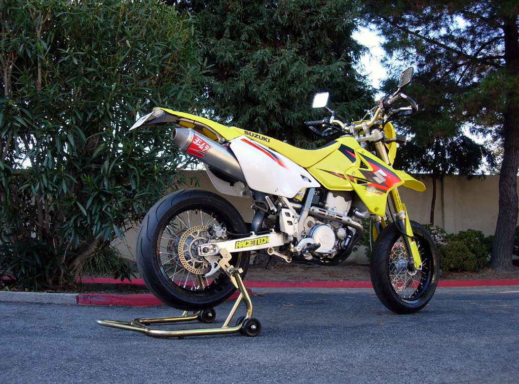

Well, I installed my R6 throttle tube, after a bit of trimming and it works great! Of course, I still haven't really ridden the bike yet (still waiting for forks and shock to arrive) but I can see how this mod would be helpful for me next year at the races.
Phase 1 complete!
As next year draws closer, i'll remove all the street stuff, install the Marchesini wheels, re-gear, full safety wire and it should be pretty close to my final vision.
Look'n good Stan. Let me know how the suspension work went (mostly the front) and the results.
I noticed the front brake line not in the stay though...
I know, you knew...:teeth
I rode the bike today, and it is nice. Stiff, but not too stiff. Feels nice and planted in the corners. Side to side transitions are very smooth and predictable. None of that 'squirrly' feeling on the stock setup. Very little brake dive. Still working out the kinks, but it's a step in the right direction. You are more than welcome to try it out.

Stans set up is still in the early stages, I'll probably be making some changes as things progress. At the moment in the forks we've gone for the stiffest springs we could find off the shelf in the right size (.54 kg/mm) but may need to go stiffer (custom). The valving is Race Tech valves with a supercross stack but that'll need some work to make it better for the street.
I'll be doing the same work on my DRZ to speed up development. It's not in Stans budget just yet but I'm looking into making some triples that will give me better geometry - more sportbike than dirtbike. I'll post up as things progress.
Cool, thanks. I think the stock fork springs are .44 and .46 is available, I was thinking about going that route. Greg shot some great shots at the last hammy ride and it appears I am riding higher in the stroke than I thought.
I still would like to see how Stan's set up works out first though.
