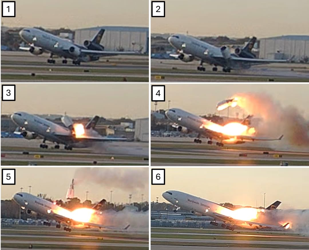

How hard would it be to detect the stress cracks? Is it something that would be apparent with inspection or not?
Depends on what the material is, and where it’s at, as in, how hard it is to get to and actually do the inspection.

I don’t know the MX interval for inspecting the pylon mount but if it’s going to fail, it’s going to fail at rotation, like this one did. The gyroscopic forces in play are tremendous, and greatest at rotation. Guys who rip an airplane off the ground always make me nervous. Anyways, inspection of things that are buried in the wing like these pylon mounts are pretty infrequent. It’s usually only done during a big maintenance cycle or when the engine comes off. If memory serves correct, this airframe had over 100,000 hours on it and some 90k’ish cycles (take offs and landings). It was a high time airframe. When I get a new airplane, I NEVER look at its cycles or time, I don’t want to know.

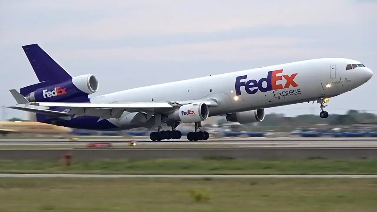

The part that really stood out to me was the reduced size of the horizontal stabilizer. Obviously enough of a change to require a stabilization system.
Not related to this crash, but I recently learned that fuel was pumped in and out of the horizontal tail for trim and balance during flight. Amazing.
