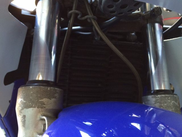

I did the seals, which was interesting and bit of a learning curve as I'm not all quite sure what I'm looking at and what is and isn't "acceptable."
The leaky fork - actually I thought all the parts where actually in good condition. I was kinda surprised. After pulling the tubes, the pits were fairly deep and doing anything to it would've been useless. I figured I've taken it all apart and might as well put it back together with new seals. Plus I needed to move the bike next week. For some reason, that side the seal was difficult to get in. I almost thought I got the wrong part :( but I eventually got it in.
The non-leaking fork - in my opinion, it didn't look that great. But I'm not sure how important certain things are though. And I was kinda stumped but happy I bought some extra parts. And the seal on this side, went in a few minutes (like how I thought it should be).

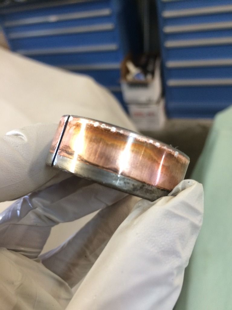

I don't like the scarring on the fork leg(?). I was disappointed. I'm not sure how important this part of the leg is? Something tells me I'll be constantly replacing the bronze bushing :(
The bushing looks like it was peened for some reason.. which I guess why the leg is fairly scarred? I replaced the bronze bushing

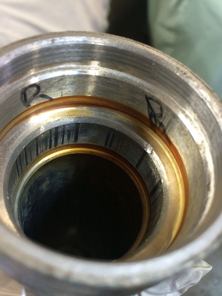

Also, this thing (?) seems to either have hairline cracks in the "cup" area.. Or could be casting marks. Idk. but nothing rides there? Spring sits on top. So I don't know if that's relevant either.

The rust spots more than likely shredded the fork seals so the seals definitely need to be replaced.
The rust spots will also shred the new seals immediately.
The best option is to replace the fork tubes with new oem tubes.
If you can't afford that, the clean the rust spots off with chrome polish and/or very very fine steel wool (00 grade iirc).
Once the tubes are clean, check for nicks by running the edge/tip of your​ fingernail along the chrome surface. Anything that catches your fingernail will usually catch a seal and turn or tear the seal.
If you can't​ polish out all the rust spots, or there are significant divots left after rust removal, then the new seals will still leak.
I have yet to find a way to fill in the divots.
Once you have completed this fork service, keep the chrome parts clean and rust free by wiping them down at least once per week with furniture polish and a clean rag and the seals and chrome surface will last a lot longer.
