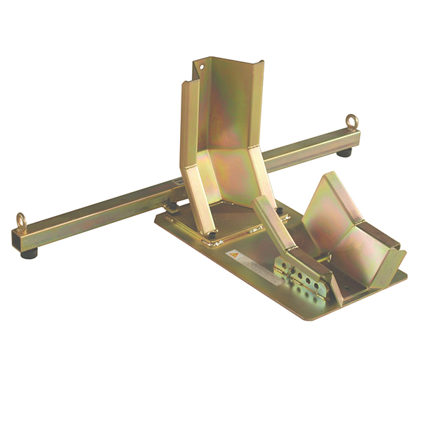

If you want to go super duper über bitchen, get this. You'll draw crowds. Some people might laugh at you for spending more on that then your entire trailer tho. :teeth
I recently saw this video, and thought it was damn efficient. :)
[youtube]uwaEABfg2rA[/youtube]
The video shows it in an enclosed trailer, so I emailed and asked them if it is safe to use in an open environment, and this was their response.
Solomon,
The restraints can work in open or closed trailers. Also, they can work in the back of trucks or in vans for that matter. The wind doesn't affect the bike much because of the direction it's facing. I attached a picture of one of our customers who transported 5 bikes together on an open trailer without issue. If you have any questions let me know.

Yup, plan on buying one of those mounts for my next trailer (when I am moving on up)
I am also a dealer for pit-bull and have sold a few of these and seen them in action - fucking awesome
