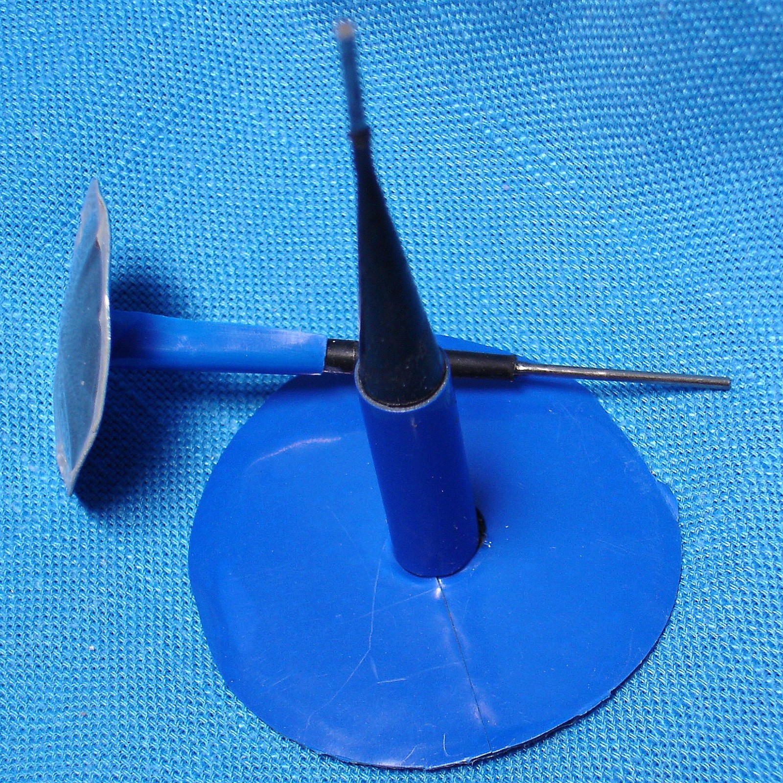

Ive patched countless tires with the plug/patch combo's.
If done right, never leaks.
I'm in the stanky safety seal group. Used them for 30 years when I was an auto mechanic and a few times on my motorcycles. It's important that the plug follow the same path as the nail or screw, or it's gonna leak. I carry wire cutters with the plugs, to pull out the nail/screw.

Another vote for sticky ropes. I never use the adhesive though, just pop them in and call it a day. Never had a failure, fixed lots of tires.
