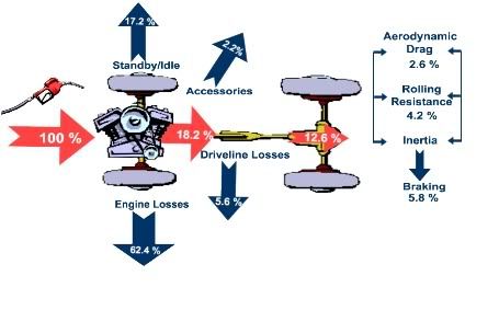

I suspect the error is in my calculation of battery pack capacity or something. Otherwise, the Volt would need to travel around 180 miles on it's battery pack to get the reported results
I'm reading their explanation and then doing as real world calculations as I can get. KW to KW and not getting the same results. I don't want to call it marketing but that's what it starts to look like. The explanation leaves out methodology so I'm digging that up.
we know how much "juice" the battery holds. We know the motor's draw, and range. We know the energy output stored in a gallon of unleaded gasoline. the EPA lists 33.7kwh as the equivalent of gasoline in their MPGe calculation.
seems all the calculations use BTUs for the fuel, kwh for the electricity then figure BTUs per kwh? why not just convert straight to kwh and be done with it?
Most of the energy going from gas goes out as waist heat in a Internal combustion engine, while most of the energy going into a electric motor is used to propel the vehicle. Regenerative braking and electrification of accessories are also other efficiency gains.

that ends up looking worse. two gallons equivalent battery storage for less than 40 miles. My Tacoma returns better than that.
what am I missing? did I drop a placeholder somewhere?
The battery will only drain down about 10.5KW when its total capacity of 16.8KW. Perhaps that's the explanation Rick?

it's equivalent energy in gallons (roughly 36kWh/US Gallon) and then add that into the total of the vehicle's fuel reserves.
Wikipedia says "officially" you can use the battery for 35 miles. the battery is listed as using 35kwh over a hundred miles. So there's what, 17.5 kwh used there, or an additional 1/2 gallons of gasoline
Given your numbers, I think this is where you went wrong.
If we take Holeshot's numbers:
Then 10.5 KWH used/drained over 35 miles traveled.
OR
Roughly 0.3 gallons over 35 miles. (assuming 33.7KWH/1.0 gallon gas)
OR
112 MPGe (I think the official number is 98MPGe, so we're off somewhere)
Back to your numbers:
379 miles per tank.
9.3 gallons plus the 0.5 gallons of electricity = 9.8 gallons
Driving a single trip 379miles / 9.8gallons = 38 MPG
But as stated, very few go 379 miles in one trip, so the more times you plug in, the more you get to take advantage of the above calculated 112 MPGe portion of the vehicle.
I never get battery pack capacities right anyway. Every time I do a napkin sketch EV I probably want too much battery.
aha, 250ml got it. I flipped the fuel capacity. NOW it makes sense. thanks!
