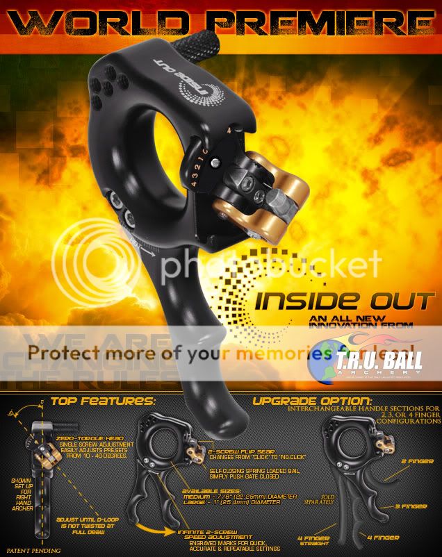

And my 5th release...

I've never understood hand-held releases. They rely solely on your finger-strength to hold the string, but a wrist-strap release makes use of every pulling muscle in your arm and back.
It's actually easier to pull a heavy bow with a hand held imho. Seems more natural than pulling through the wrist.
Bigger factor for me though is stand hunting - You can snap the t handle onto the loop and leave it there. No fumbling around trying to get the wrist release snapped on. ymmv.
I found that it DOES require a bit of practice to pull through your wrist (think of your forearm as a wire, and pull from the elbow), as it's not natural, but it's ultimately a more stable method. IMO.
Or, you could also go the other direction and say that the wrist release will always be on your wrist while the hand-held release is just another thing for you to drop while you're in the tree stand.
