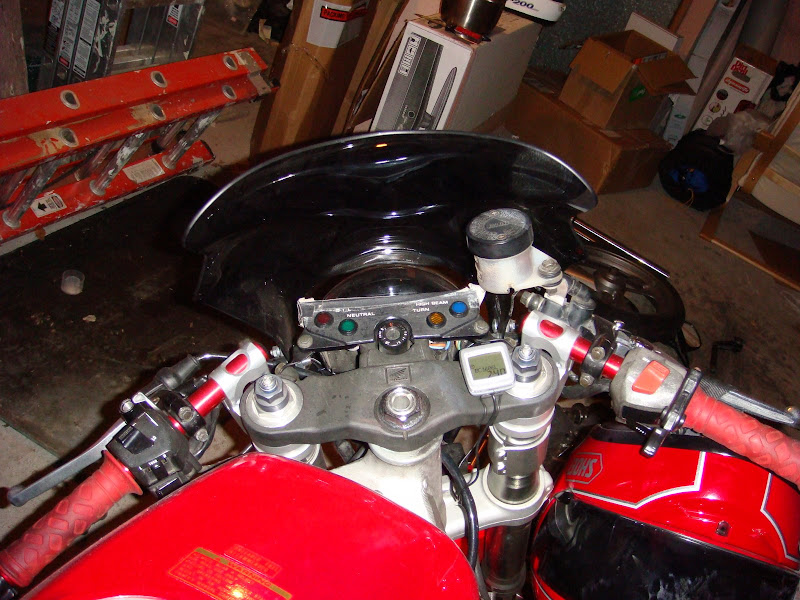

I fabbed the subframe out of thinwall stainless tubing.
looks way cool -
keep it single disc
+1 on the SM cockpit -
what're clox & headlite gonna be?
remounting the rad underseat?
The single disc works better than I thought it would. Im using a pump from a quad.
Right now I have an endurance computer for the speedo. I think down the road I'm gonna use a gps device. Not gonna use a tach or anything else. Maybe just an idiot light.
I have two paths I may go with the headlight. One is just a classic style large round headlight, the other is a skull that I would mount a headlight in. The skull is a harbor freight welding hood that I mounted on there for shits and giggles..... it looks pretty freaky on there. The round headlight would look much classier though.
The plan is to just fill in the the subframe with aluminum or painted plexiglass panels. Rear fender is gonna be a harley blank fender that I will custom cut.

ah ha, I just noticed the suicide shifter! you are nuts, in a good way.
keep the pics coming and this thread alive with your progress.

how will ya work the cluch & shifter at same time....?"
excellent packaging on the subframe
I think that skull is superb - please keep it

I've got a complete F4 front end to put on it and it's already got a penske shock.
Anyone have any ideas for an instrument cluster since the F4 front doesn't have a mount?
this is a 929 fronter.. im not sure if this applies but see where the bolts of the top clamp holds the fork tubes? there is a narrow piece of aluminum there that is bolted then twisted to mate with the stock gauge cluster...

The shifter works best for clutchless upshifts..... it's more of a novelty than anything. The normal shifter still works but it's pretty fun to do the upshifts with the suicide shift.
haha yah the skull is crazy it looks even better in person. I have a couple projector lights that will look like eyeballs, it's gonna take some creativity to make it look right though.
