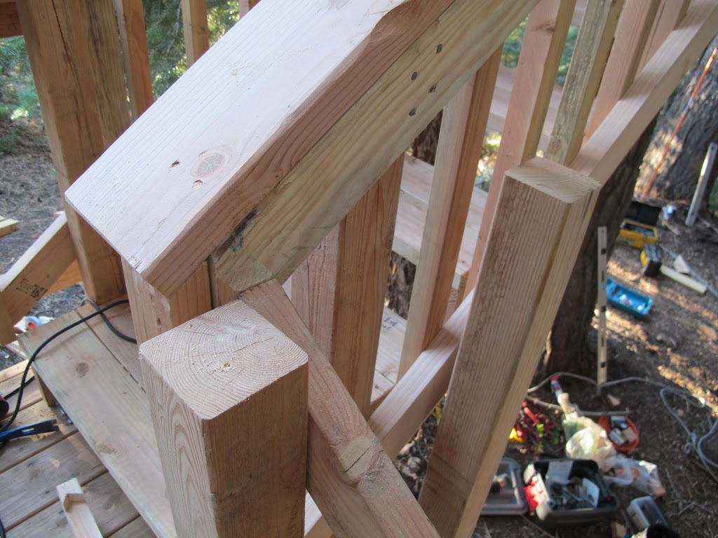

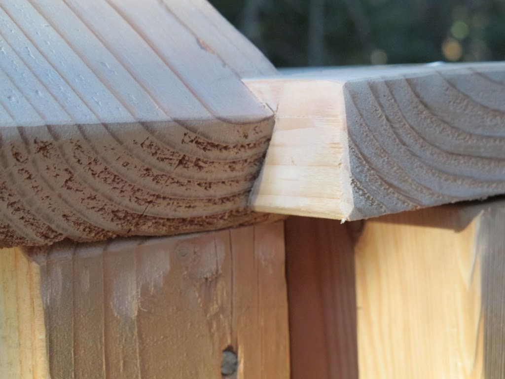

As there was adequate time to complete these tasks and I was down to the details, I took a little extra care with fitting a few pieces with intricate cuts so they could interlock with other features. The most vivid example was a short piece of rail cap that needed to be installed next to a stair rail. The path of the stair rail extends through part of the space that the rail cap would occupy. The simple approach would be to rip the rail cap to a narrower dimension, but I wanted to keep it the same width as the rest of the railing, so I cut out a void where the stair rail was.
Here are the two posts that need a rail between them. Note how the star rail terminates right next to them:
This is the piece I cut to fit in there, alongside the tool I used to make the cut:
Nice flush fit Andy! I have seen those little saws on some tv shows, but have not wielded one myself. Looks like it is very good in tiny quarters and odd angles. Awesome project, very well done :thumbup
Thanks, Sallie.
That tool is one of those things that you look at and think it probably wouldn't work very well. Don't be fooled; the thing is amazing.
