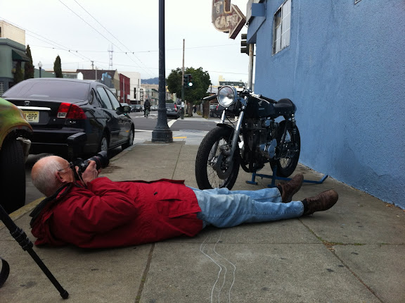

Here's Bob Stokstad shooting pix in front of Charlie's Place. We should have some photos to show you tomorrow.
