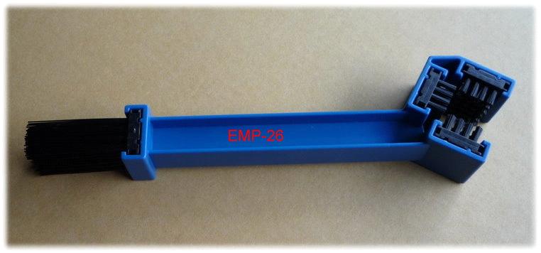

or a chain brush!
those things are magical!!!!!

One of these makes it easier.

I used a hard bristle nylon brush, and thought it worked fine. Then I got a Grunge Brush on clearence, and what a difference. The brush cleans better, makes the job go quicker, and because it's somewhat enclosed around the chain there isn't as much splatter. Tooth brushes are just too small, but taping them together is a good idea, and use the hardest bristle you can find.

2.) Use Grunge Brush to clean off the grime
