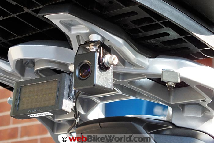

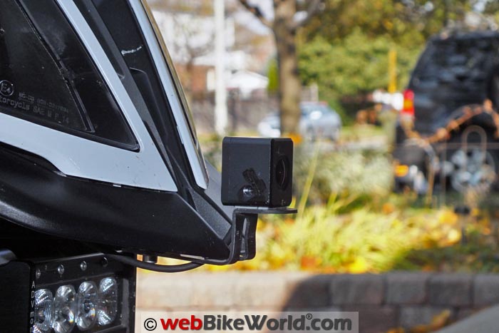

http://www.webbikeworld.com/motorcycle-video-camera-reviews/innovv-k1-review/
