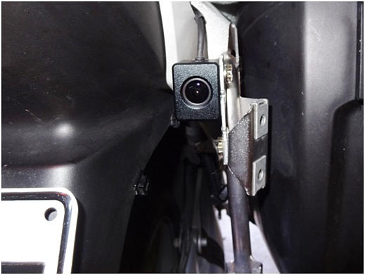

I absolutely did not want to mount the cameras in a way that detracted from the aesthetics of the bike...more difficult than I thought. There's not a lot of options that give a good view without looking very out of place.
After some trial and error, I bought some corner braces to use as mounts for the cameras, and bent/cut/drilled them to size.
Front camera is attached at my lightbar mounts. I shortened one side of the corner brace and bent the whole thing towards the center of the bike then straight, to clear my turn signal.
The rear camera is attached to a quick release anchor for my top box. The first version used an 'L' bracket but I decided it needed to be closer to the rear of the bike so I bent one side of a corner brace at a right angle.
