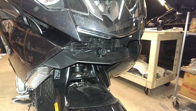

The last blog, INNOVV C3 INSTALL ON BMW K1600
http://www.innovv.com/#!INNOVV-C3-INSTALL-ON-BMW-K1600/c1rny/AC34D669-64E2-4EDD-B014-A4C7A03002FB
4a7279_7dae909c98574b12a8ab309b0c73e274.jpg_srz_p_630_357_75_22_0.50_1.20_0.00_jpg_srz

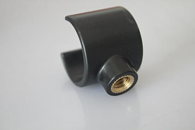

Free Lens case clip dispatch
Received many message mentioned below lens case clip is the most useful mount to allow C3 lens can be mounted on anywhere of motorcycle, so would like to have one more.
Now set up the program, that starting from today till end of Feb, you can leave a message on forum to get free Lens case clip. :):):)
4a7279_8391063b3b3844fa8a3324435019a104.jpg_srz_p_400_267_75_22_0.50_1.20_0.00_jpg_srz
http://www.innovv.com/#!product/prd1/3270383811/the-c3-lens-case-clip
Ill take 3 more as well as I can mount them and leave them in place.
