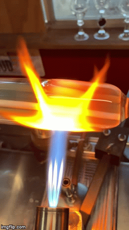

I took a piece of 45mm OD tubing, 5mm wall, and put 4” long 7mm color rods inside, with a 20mm solid rod in the middle of it all. Sort of like a roller bearing. It’s all assembled cold then warmed with a Bunsen burner. Then I work from one side to the other, heat the hell out of it, and vacuum out the air from the gaps between the color rods. Then pull it down a bit and twist it all up into the spiraled lines.
The vacuum makes for really nice clean prep with no air bubbles. You can replace the solid core with a tube and use the same technique to make color tubing
Edit- here’s a gif of the process. I have a swivel on the other end of the tube, with a 1/4” hose going to the intake of an air mattress pump I control with a foot switch
via Imgflip GIF Maker
