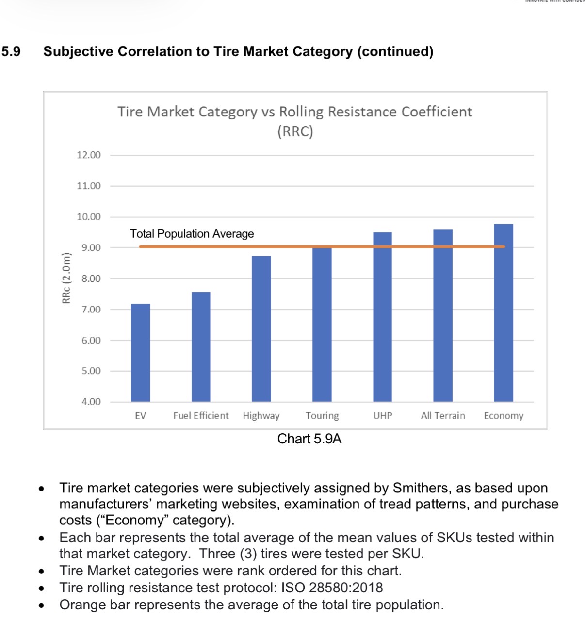

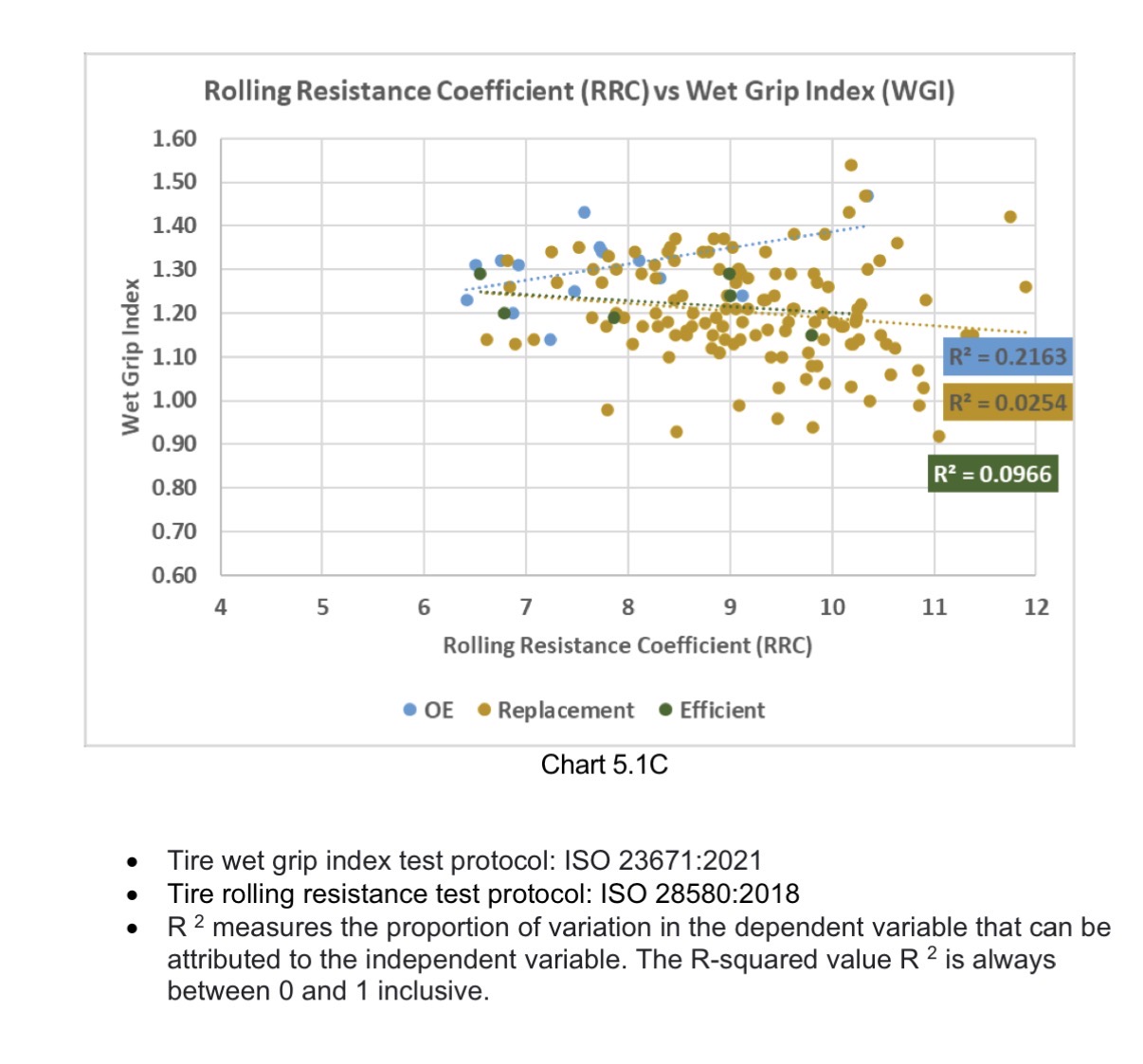

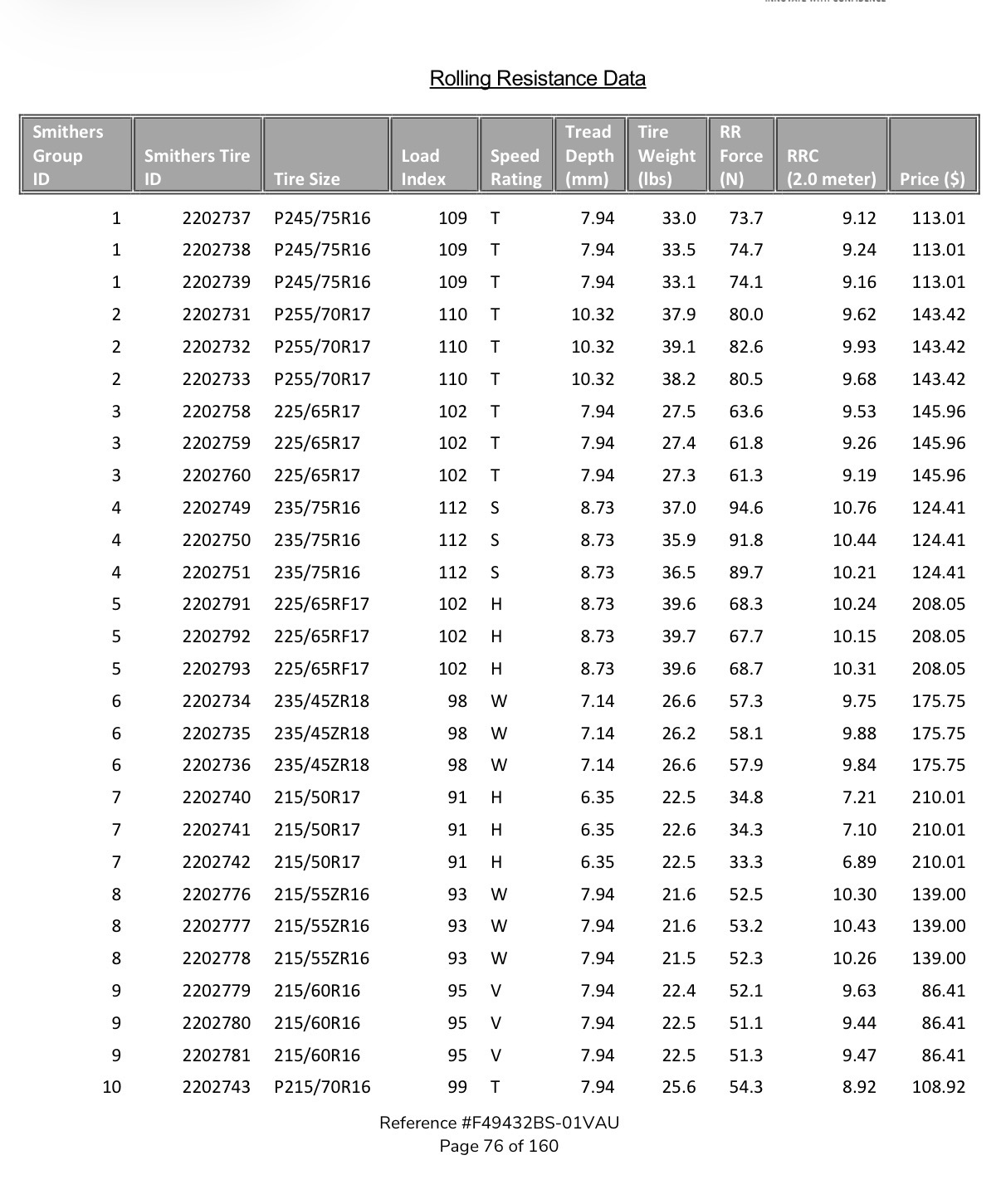

Oooo I found the test data.
Look like the CEC had the whole tire market evaluated. Here’s 3 of the like 50 charts in the report. Remember, the limit for car tires for Phase1 is 9.
