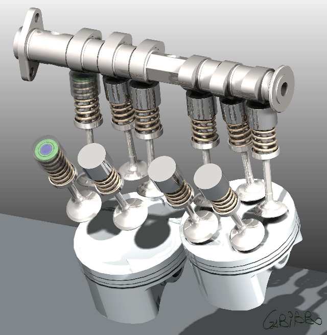

Only the 750 and 1000 got 5 valve heads. The FZR600, FZR400, and FZR250 had 4 valves.

... be interesting to compare the
bores of the 1000, 750 and 600 ...
Yamaha may have done the math
and figured the 600, 400 and 250
didn’t have enough room ...

I think Yamaha may have been
able to design a SOHC five-valve for the FZR 600,
but given the complaint about the SOHC 660 Tenere
(low compression, low red line), probably didn’t
make sense ...
... gets us back to the points about
the geometry of the three intake valves
just not being able to work compared to
four valves ... :dunno

What about Honda's 8 valves per cylinder and oval pistons for their 4 stroke NR500 and NR750 engines?
I thought that was pretty Wild and innovative!
I bought an NR750 piston about 20yrs ago. When it comes to NR (not round) pistons, the most challenging thing to manufacture and get to function correctly were the rings. Because of that, I wanted them too. One set of rings were 2x the cost of the piston, and the piston was not cheap. After months and months on back order, I gave up.
the oval piston rings were one of the things I loved about the NR750 ... getting back to Mr Honda's first-principle roots--as I think making (better) oil rings is how he began his amazing career ... :ride
edit: AI haz all the answers--
"Soichiro Honda's early career involved piston rings, as he founded the Tokai Seiki company in 1937 to produce them for Toyota. His initial attempt was unsuccessful due to poor quality, leading him to study metallurgy at the Hamamatsu Industrial Institute to improve his manufacturing process. After succeeding in producing high-quality rings, he secured a contract with Toyota, and later sold his company's remains to Toyota after wartime damage to establish the Honda Technical Research Institute in 1946, paving the way for his famous motorcycle and automobile ventures."​
of course, I have no idea how they make oil rings ... I only know Kawasaki made a lot of bad ones for KLRs ... :laughing
