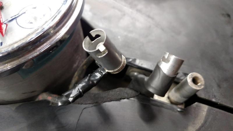

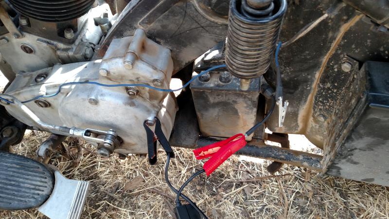

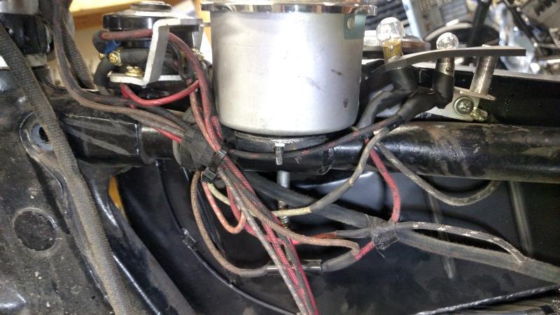

Just after we rode over Tioga Pass My bike blew a fuse. Then popped another. The sun was going down and we were about 40 minutes from Groveland where I was thinking we would stop. So I disconnected the wiring at the battery and the coil and ran a single wire directly from the battery to the coil. It was getting dark (I had no lights) so we stopped at Bucks Meadow where there is a hotel and restaurant. This meant no charging system on the last day of our ride. But my bike made it to the East Bay (140 miles) were we stopped for an hour, had a snack and charged my battery.
Today I took the left tank off the bike and found the tape covering the dash light was loose and the light was grounding out on the tank. So I rewrapped the wires and added a additional layer of shrinkwrap tubing.

... here we are, at the T-intersection on the west side of Tioga Pass,
where the Indian started popping fuses ... we started to roll
down the hill toward Groveland, going through Kalle's fuses
and then my fuses, before Kalle simply bypassed his
electrical system with his alligator-clip jumper wire,
by hooking his battery up directly to his ignition coil ...
We spent the last half-hour rolling along in the
dark, with the Tiger's headlight on and hooked up to the two six-volt
batteries in my saddle-bags, hoping we had enough
volts to keep it running with the lights until
we could get to a motel where we could fuss with
the Indian and put the Tiger's tired batteries on
the new trickle charger I'd purchased in Pahrump to
replace the cheap $20 Cycle Gear charger that had
quit in Furnace Creek ... :laughing
We finished pushing our luck in the dark in Buck Meadow,
where we found a motel and a good restaurant ...
Kalle got the Indian jury-rigged to ride home the
next day without the headlight, and we stayed off
the interstates in the Bay Area by taking Crow Canyon
to Redwood Road, where we stopped at the
big campground above the golf course to
put the Indian on an RV-full-hookup campsite
electrical outlet to charge it up for the final push
home ... :ride
