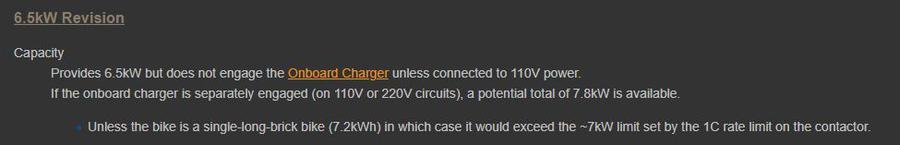

Very happy to have purchased a 2017 Zero DSR! Excited to pick it up. Even more excited that I can combine the existing Charge Tank with my J1772 female adapter to charge the bike at 7.8kW at EVSE charge stations. All the ChargePoint stations i've used have two ports at each station so as long as both are free I'm good to go. One for the ChargeTank the other for the plug adapter.
Pro tip, if you want to use two plugs on a charge point at the same time (Dub-J), you want to have 2 separate charge points accounts / 2 RFID cards.

Thank you for that tip. I have one CP account on my cell phone I guess for the other I will just use one of my RFID cards. My battery is the older 13.0kW model so I'm anxious to see how fast 7.8kW charges the thing. Zero has been really responsive to my questions. One of their actual engineers has been chatting with me.
Around two hours. It's simple math. 13KWH / 7.8KW=1.66 hours.
But . . .
Now add around 22 % to that time. You cannot charge a Zero 13 KWH battery to a full 13 KW. But there is the loss in heat. Also, you will not get 7.8 KW charging under 10% or above 90% SOC. You then have around two hours from near 0 SOC to 100% full after everything is taken into consideration.
FWIW, I charge my 2017 Zero SR at around 7.9KW on the road. Two 3.3 KW external Elcons and the 1.4 KW OBC.
